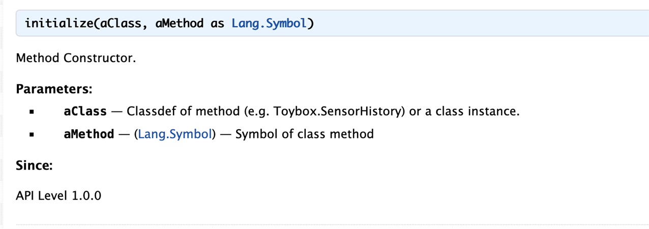

    The above docs as well as the docs for Method.initiallize() do imply that you can create a new Method object with a function that in a module, or a static function on a class.
    https://developer.garmin.com/connect-iq/api-docs/Toybox/Lang/Method.html#initialize-instance_function
