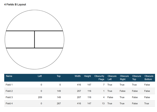

    As a matter of fact, the device reference says both fields should be equal width: 207 pixels, which points to a 2-pixel wide space in the center, and which doesn't seem to matches the images that OP posted.
    [https://developer.garmin.com/connect-iq/reference-guides/devices-reference/#epix%E2%84%A2gen2quatix%C2%AE7sapphire]
