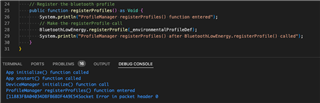

- The exact line of the crash can be narrowed down by adding printlns before and after line 37 in ProfileManager.mc
public function registerProfiles() as Void {
  System.println("before crash"); // <== new println
  BluetoothLowEnergy.registerProfile(_envProfileDef); // <== (originally) line 37
  System.println("after crash"); // <== new println
In this case, "before crash" will be printed to the console, but not "after crash". If I comment out the line with registerProfile, the app does not crash. I am also able to run other (non-BLE) apps just fine.
