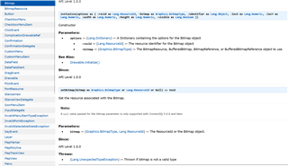

  • https://developer.garmin.com/connect-iq/api-docs/Toybox/WatchUi/Bitmap.html
    In contrast fr935 is on CIQ 3.1.6, and the SDK 3.1.6 docs say:
    (back then the SDK and CIQ versions were synced)
    So it seems to me that for a real fr935, only a resource ID is accepted as an input to Bitmap.initialize() / Bitmap.setBitmap.
