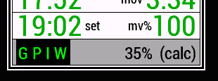

Anyway, one of the things my data field does is track the status of the battery... I calculate the "time to live" based on watching the % charge drop over time. That takes a little time before I can offer that estimate (calc = calculating). I also note if the device is plugged in, and if so the bottom bar turns GREEN and I display (chrg).
