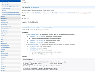

API doc: ChannelAssignment.initialize code example incorrectly features direct call to GenericChannel.initialize()
using Toybox.Ant;
var channelType = Ant.CHANNEL_TYPE_RX_NOT_TX  // Bidirectional Receive (Slave)
var network = Ant.NETWORK_PUBLIC;             // Ant public network
// Get the channel
channelAssign = new Ant.ChannelAssignment(channelType, network);
// Initialize the channel - assumes message callback method
GenericChannel.initialize(method(:onMessage), channelAssign);
Clearly Generic.Channel.initialize() can't be called directly; this should be replaced with a call to new GenericChannel.
https://developer.garmin.com/connect-iq/api-docs/Toybox/Ant/ChannelAssignment.html

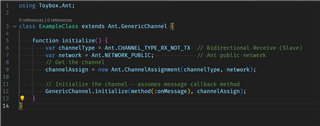

    In other words, the example makes sense when rewritten as this:
    I doubt many CIQ noobs would make that leap tho.
