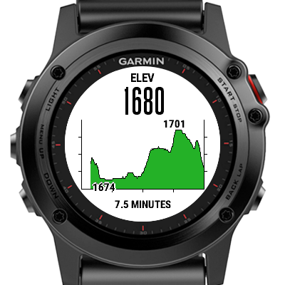

Well, I have a chart class, I might as well use it to the max, right? So here we have some data fields.
Changelog:
1.3 - Variable durations, flip pace chart to match Garmin Connect, add power
1.2 - Increase durations, increase font size for long thin layouts, try to clip spikes in pace/speed
1.1 - Rework smaller layouts for better legibility, add speed, cadence and elevation
1.0 - Initial version (HR / pace)

    So I'd definitely be interested in feedback here:
    What other data fields should I produce? I'm guessing that speed and elevation are obvious candidates, any others?
    Are you more interested in using them full screen or with more than one field in a layout?
    The data fields copy the previous widget/app layout when used "full screen" but then switch to superimposing current/min/max over the top of the chart when they have to share the screen, since that uses less space. I'm not sure that the minimum and maximum are as clear as they could be in that case, but I tried them float over the chart as they do in full screen mode and they just got in the way...

  • Is this better? :-) https://apps.garmin.com/en-US/apps/0bbabaa9-aedf-44e8-913b-60e4198be083
    That looks cool, but why do you display only the last 10 min? Is it possible to show more, like the last 1 or 2 hours?
    Can you show the elevation since the start of a Activity or can this not be done with the SDK?
