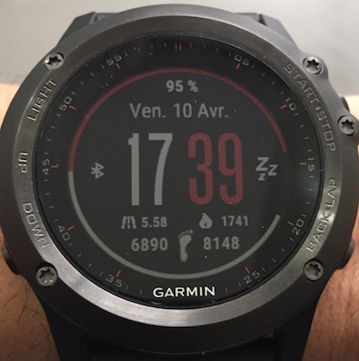

Black background, red minutes, 12/24H mode.
Displays :
- batterie percent and a progress bar in red on top
- steps, step goal and a progress bar in white on bottom
- bluetooth status
- sleep mode status
- distance
- calories
Doesn't displays seconds because with the low power mode I prefer not.
V 1.3

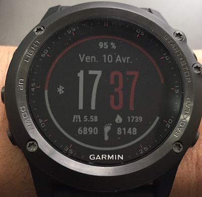

V 1.4
- Back to old design due to bad graphic behavior in 24H mode after 20H
- Change (again) arc drawing method and merge some bitmaps to optimize more the performance
- 2 digits for hour in 12H mode

  • The new design with the small battery arc has a little design flaw - in 24h mode, the first of the 4 time digits is superimposed with the battery gauge. E.g. 08:35 the 0 collides with the battery gauge.
    Personally I preferred the previous approach with two big arcs ... Your new method of drawing arcs is more beautiful though for the big arc - maybe consider reverting to your old double gauge with the new arc drawing method ...
  • Former Member
    Former Member over 10 years ago
    Yes I saw it yesterday evening when hour switch to 20 :)
    I'm such a n00b ...
    I'd like to keep the two arcs like before but this new drawing method fills the whole screen with circles and I haven't find a way to draw only half circle.
    Perhaps I have to use fillCircle for one and drawCircle for the other one.

    Just updated to 1.4 (see 1st post for details)
  • This is definitely my favourite watch face. Just updated to 1.4. I'm glad you went back to the old design of two arcs. This layout is nicer looking.
    However, just a small criticism. I'm not a fan of always showing 2 digits for hour in 12H mode. It's not the proper way to display the hours. The 12H clock does not normally display a 0 before single digit hours. For example, 4 pm should read 4:00pm, not 04:00pm.
