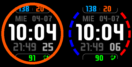

  • Hi, Gurjon,
    I love your watchface, it's the one I've been using for 8 months. Occasionally, with the previous version, your watchface had an error, like a yellow ring that happened randomly. With the latest update of your watchface and the Garmin FR 935 system, today this ring doesn't turn off, it's permanently on the screen. I try some kind of things without any results. This error only occurs, in my case, when I set the continuous bar, if I set discontinuous the error does not occur. Can you solve it? We'll appreciate that, so, thanks in advance. Update: I have solved this issue by removing and reinstalling the watchface and, at the moment, it works fine, but I think the bug is present in the background.community.garmin.com/.../1371252.png
