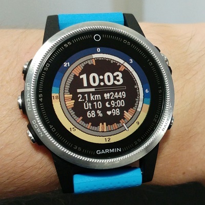

Hello, I have created a new round watch face My Day 24. You can see your activity in the last 24 hours. Sunrise and sunset time is displayed in the outer circle. The second circle shows the sleep time and a sleep quality (deep sleep, light sleep). The inner circle is your heart rate history in the last 24 hours. Download here
Currently both Fenix 3 and Fenix 5 are supported (as well as Vivoactive 3 and FR935), just the Fenix 3 does not support the sleep detection (background tasks are not supported on this hardware). This watch face is still in development, I plan to implement more customization options later (different data fields, custom colors, status icons for alarm and notifications, different fonts etc.). You can send me your feedback, what would you like to implement :)

I have implemented my own algorithm for sleep detection. When this watch face is active, it reads every 5 minutes data from the accelerometer. The time of the sleep that is displayed can be different from the time displayed in the Garmin Connect app. I hope it works well on every hardware and with every person, I have tested it only on the Fenix 5S. But it seems to be working well :)

The inner circle shows the heart rate in the last 24 hours, every bar is a 15 minute time period. When you start this watch face, only the last 4 hours are loaded from the history. You need to wear it whole day to get all the data.

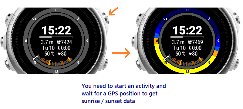

The sunrise time is calculated from the GPS position from the last activity. If you see a gray circle on the first startup, just open a running / cycling activity, wait for a GPS fix and return back to the watch face.
