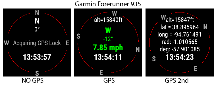

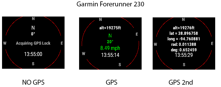

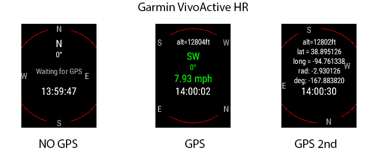

[Screenshots]
[Features]
- Upon starting this widget it will at first show heading and compass using the internal sensor while waiting for a GPS fix as well as the current time
* The compass will also show an offset in degrees from the nearest general direction (N, NE, E, SE, S, SW, W, NW).
- After a GPS fix is found this will be used for compass information, also the following will now be displayed:
* Altitude (in meters or feet, depending on settings for the watch)
* Speed (in km/h or mph, depending on settings for watch)
* Speed and direction/offset are colored based on GPS signal (Green=good, orange=usable, red=bad/unavailable). In practise it's always green it seems though.
* Touching the display or pressing start button will show another screen with the compass but also lat, long, rad and deg values.
[Settings]
None, values are displayed using the settings on the watch itself...
