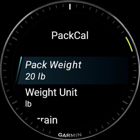

Setting it up
Set everything right on the watch: in the activity, hold the menu button, pick Connect IQ Fields, then PackCal, and set pack weight, units, terrain, and energy unit (plus a body weight if your Garmin profile has none). Change your load mid-activity and it updates within a second. Or open PackCal in the Connect IQ app, where the same settings live.
