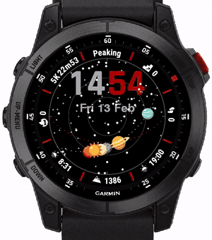

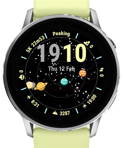

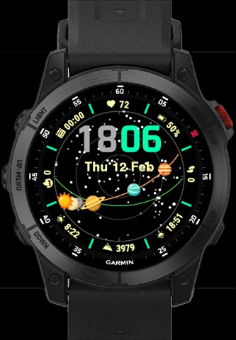

For the last month I was working on a watch face in my spare time: Planetarium. My hobby is astronomy, so it's a very astro oriented watch face. Besides the time and 8 fully customizable data fields it shows the current position of the sun, the moon, the planets and the 300 brightest stars, as visible from your location.
Here are some screenshots from the simulator:
I'm super excited to showcase it here and I would be really glad to hear some thoughts from experts like you. Do you see something that can be improved?
I have one technical question. Is there a way to have the customization of the data fields in the same way as the native watch faces? Right now I use Menu2 where I list all the fields ("top", "top-right",  etc) and when the user selects one, I open another Menu2 with all the possible complications.
I would like to have it in a way where the data field blinks and the user can cycle through all the complications. I couldn't find any examples of that though. Any help here would be much appreciated.
Let me know what you think about the watchface Slight smile
