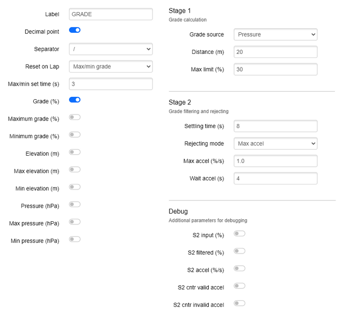

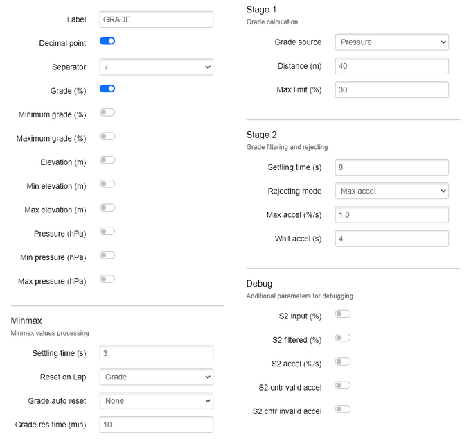

Configuration screens on Garmin Express:
Features:
Label
- the title of the datafield, maximum 20 characters.
Decimal point
- when switched on, the selected variables are displayed with one decimal place.
Separator
- the separator between the selected variables.
Grade (%)
- display the output grade from stage 2.
Minimum grade (%)
- display the minimum of the output grade from stage 2.
Maximum grade (%)
- display the maximum of the output grade from stage 2.
Elevation (m)
- display the altitude above mean sea level.
Min elevation (m)
- display the minimum altitude.
Max elevation (m)
- display the maximum altitude.
Pressure (hPa)
- display the ambient (local) barometric pressure, it's smoothed by a two-stage filter.
Min pressure (hPa)
- display the minimum pressure.
Max pressure (hPa)
- display the maximum pressure.
Minmax - Minmax values processing
Settling time (s) [1 - 20]
- min/max values settling time.
- default value is 3s.
Reset on Lap
- whose min/max values to reset when "Lap" button is pressed.
- default value is "Grade".
Grade auto reset
- which grade min/max values to auto reset.
- default value is "None".
Grade res time (min) [1 - 120]
- grade min/max values auto reset time.
- default value is 10.
Stage 1 - Grade calculation
Grade source
- grade calculation source, where "Min (Press, Alti)" means the one whose output is smaller in absolute value.
- default value is "Pressure".
Distance (m) [1 - 100]
- traveled distance, based on which the grade is calculated.
- default value is 40, my advise is to not set it below 10.
Max limit (%) [1 - 100]
- if the grade is higher than this value, it's rejected.
- default value is 30, you can change it depending on the maximum grade you will be climbing.
Stage 2 - Grade filtering and rejecting
- this parameter defines the settling time of the filters.
- default value is 8, my advise is to not set it below 4.
Rejecting mode
- default value is "Max accel".
Max accel (%/s) [0.1 - 10.0]
- the maximum allowable grade increase in 1 second.
- note that if you change the settling time of the filters, the accel may change.
- default value is 1.0.
Wait accel
- time to wait for valid or invalid grade accel.
- default value is 4.
Debug - Additional parameters for debugging
S2 input (%)
- display the input grade of stage 2.
S2 filtered (%)
- display the filtered grade in stage 2.
S2 accel (%/s)
- display the grade accel in stage 2.
S2 cntr valid accel
- display the counter of valid grade accel in stage 2.
S2 cntr invalid accel
- display the counter of invalid grade accel in stage 2.

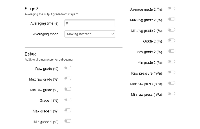

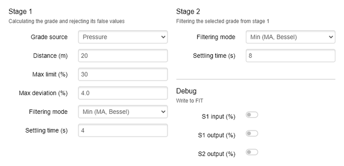

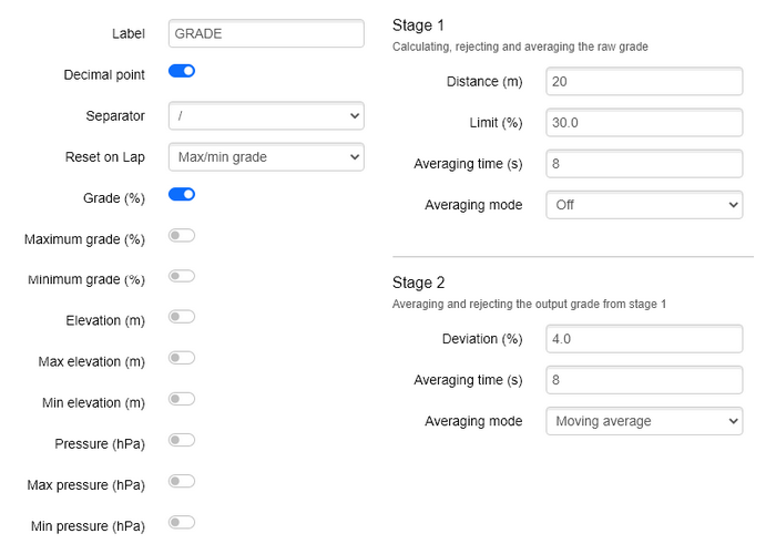

  • Looks interesting. I have a few questions. What happens if a grade is rejected? Does the next grade estimation somehow account for this? How far can you reduce the lag without running into excessive noise? On a 530, the standard noise-free grade has a lag of about 8 seconds, so I am curious if you can go substantially lower. Would you be interested in making your estimation technique a Monkey barrel that (for some form of compensation) can be introduced into other apps?
  • The raw grade is calculated from the change of the raw pressure over the elapsed distance "Distance (m) [0 - 200]". In stage 1, you reject the calculated raw grade when it's above "Limit (%) [0.0 - 100.0]". In stage 2 you calculate the moving average of the output grade from stage 1. This average value shows the tendency of the raw grade, when the raw grade is too far from the tendency, it's rejected. Too far means if the difference between the tendency and the raw grade is more than the "Deviation (%) [0.0 - 50.0]". In stage 3 you average the valid raw grade from stage 2, to stabilize the signal. So, for the lag, first you have to ride 20 metres for the raw grade calculation, then you need 8 seconds for the grade averaging in stage 3. Another 8 seconds for the tendency in stage 2 is needed only at first start or when the change in the grade is more than the Deviation for very long time, for example: you ride +15 degrees uphill and after the grade is stabilized around this value, then -15 degrees downhill for more than 16 seconds, when the grade will be stabilized around the new value. Of course you have full freedom to change what you want, but i made a lot of tests and the default settings seems to me the best choice. I tried some low pass filters, but the results are worse. By the way, if you go to the debug options and check to display the "Raw grade (%)", you can see what mess is there, specially if some wind blows over the computer or if you shake (push) it a little harder with your hand ;) On my 1040 when it's on the mount and i shake (push) it, in some cases the raw grade can go between +150% and -150%! I can try to do the barrel, it's a good idea. I will wait some time to see which is the best algorithm and how are the reactions. I think to try Butterworth filter soon, i will implement it if it has good results.
