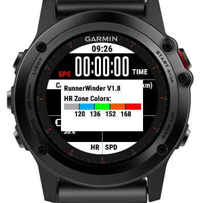

    I am the author of Runner Window. After finishing every function I need and making Runner Window run stably, I went back to my daily job soon and became a *PURE* user of my own data field. :P I don't come here often. You can find me via my facebook page, https://www.facebook.com/darkthread.net , and send me a message, the response will be faster. Since Runner Window's thread is started, you can post your suggestions and feedback here, too.
    Back to TOD issue, I totally agree with Webvan, the TOD font is too small but there is no room for bigger TOD on FR23x/630, so we have nothing to do on this, ha. An idea is to make the TOD inverse background color, will it help?

    Yeah, according to my experience, GPS bar is rarely used because you will notice GPS signal is lost by out of current pace. I will try some different layout these days. Thanks for suggestion.
  • Runner Window FR 1.6.2 Preview is coming.
    * Remove padding zero of timer hour
    * Larger font for TOD
    * A little layout adjustment
    Anybody want to give it a try?
  • Thanks for the new version, installed it on my FR235 and will give it a try while running tomorrow. TOD does look a lot BIGGER ;-)
  • Finally got to try it yesterday and it worked great with the TOD now being perfectly legible, well done!

    Accroding to my understanding, 3rd party datafield can't get any information about "Lap" from current programming interface and there is no custom datafield giving lap data. (If I am wrong, please correct me.) I don't think it's possible to add lap info to complex even simple custom datafield.
    About the colored pace, I will consider your suggestion and give the "colored text but not colored number version" a try. :P
  • About the colored pace, I will consider your suggestion and give the "colored text but not colored number version" a try. :P
    Colored header edition is coming.
    Here are the preview program files: (for fenix 3 & FR235)
  • That was fast thanks! You may want to rename the downloads though as I tried the wrong one first ;-) Will give it a try this morning.
    That's too bad about laps, but that would explain why there are no complex DF that use them. Hopefully Garmin will add access later!
  • Gave it a try this morning, the pace coloring is less "distracting" but for some reason the pace field seems smaller than before, which it isn't! I think the coloring gave that impression and made it stand out versus the other fields and especially Average Pace...
    Could we give it a try with the green font color maybe? Thanks!
