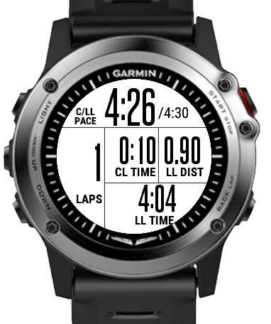

DATA FIELD: Lap By Position
Bringing back most of the features of the 310xt/910xt "Lap By Position" function.
!!! Requires GPS signal to function !!! (This may not work well indoors or if VERY poor GPS signal)
This data field uses your "GPS Start Position" as the autolap point. Every time you pass your start position the data field will auto lap and provide Last Lap Pace/Speed Distance and Time. In order to Auto Lap, your watch must be within 30 meters of your starting position and must travel 100 meters from the starting position. This prevents false laps, but is small enough to work on a standard 400m oval track.
NOTE: This does not update your FIT file, by placing laps in your FIT File. At this time Garmin SDK doesn't not allow the recording functions in a data field. This just provides real time lap information on the data field screen.
[URL="https://apps.garmin.com/en-US/apps/56ac6530-5b61-4ed2-9e2f-d682064efeb6"]"Lap By Position" Fields[/URL]
Current Pace/Speed** | Last Lap Pace/Speed **If no GPS Signal, "NO GPS" is displayed.
Current Lap Distance | LAPS | Last Lap Distance
Current Lap Time | Last Lap Time
"Lap By Position Simple" data
Up to 3 data information fits into single field and is configurable
SpeedPace / Laps / Timer (Current or Last)
CLPACE = Current Lap Pace
CLSPD = Current Lap speed
LLPACE = = Current Lap Pace
LLSPD = = Current Lap Speed
Lap = Lap number
CLT = Current Lap Tim
LLT = Last Lap Time
-The Last Lap Fields will update after the first lap.
-Showing of Pace and Speed is configurable through Garmin Express or Garmin Connect.
–All Display settings Metric/Statute are auto adjustable by user watch settings.
-Fields are auto-adjust for all data ranges for maximum readability through out your entire activity.
-Auto background color Black or White background based on app settings
