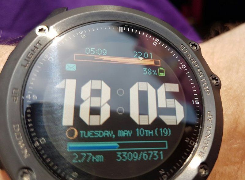

  • Looks like a problem appeared when I hit a lot of daylight. This happened when the sunset was at 22:01 as shown on the picture.
    Might be too much daylight for the watchface this far north? :)
    Have tried booting the watch, adding the watchface and everything else I could think of. Looks like a bug.
    BTW: could we have more fonts to choose from for the time, please. Other then that - great watchface!
