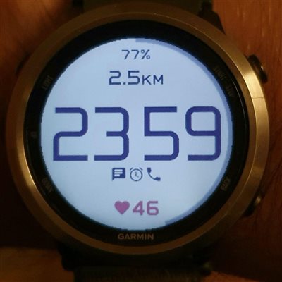

  • Final Product.
    Got my set up how I like.  Days of the week show up in the lower strip in fixed position which gives a good quick visual reference  I separated the minutes and hours in different fields so the minutes are always in the same position.  The ring is dusk/dawn and it rotated counter clockwise with the upper midline being “now.”  The bottom left number on the stripe is the hours in 24- hour time.  The upper stripe number is intensity minutes.
    I think it’s a cool setup that could be modified to personal preference.
    To get the days of the week to cycle,
    go to the set up page in Connect IQ,
    put the 1st half and second have of the strings in,
    select “save and*” rather than “current profile,”
    then pick a profile number, (I did 1 as Sunday and so on,)
    below that select the day of the week for that profile to display.  My watch is set for Monday as the start of the week so I ended up using
    profile 1 (Sunday) as day 7
    profile 2 (Monday) as day 1
    profile 3 (Tuesday) as day 2, and so on
    this was probably unnecessary because I can assume you could just make profile 1 be Monday so the number correspond if you have your watch set up for Monday as the first day of the week
    color scheme could have been better but I’m not going back now!
    If you want to modify it, start with Sunday, modify what you want, save that as a profile on the M2 designer (like profile 10) and then great the rest of your week days.  I stole this days idea from someone else here sorry I don’t recall whom
