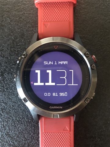

  • Perfect app, thank you. First try .. F6x
    01ZW2525111WDPO1011XGWc020Vd121VcVf1XGYL03X7C11XGVk035C13NC13XDC11YJYL03Ve514R0Vw1WBYL0YQH0RZCH0Vd3NF13Va513U611VyVy0XOM0VW70Vf0XGY9YE170Vf0XGWNYE11YYVy0W5W0311VyVZ0WMC0Vf1YYVZ0VqVV0Vf1XGYx03VV314L0Vf1XGF04VW0Vf3Vv217Y6Vf0YGVy1Vo70Vf0WDVy1Vo70Vf0WpYT1Ve70
