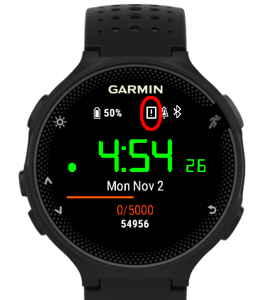

  • Still learning my way with the new forum SW, but here's what Simple Darkside looks like:
    community.garmin.com/.../1228431.jpg

  • The box with the ! is for unread notifications. The "zz" is shown during your configured sleep time, the o with a line is "do not disturb" mode, the bell is an alarm is on, and the BT symbol is connected to the phone. On some watches, it will turn pink when in "Do Not Disturb" mode instead of the DND icon being shown

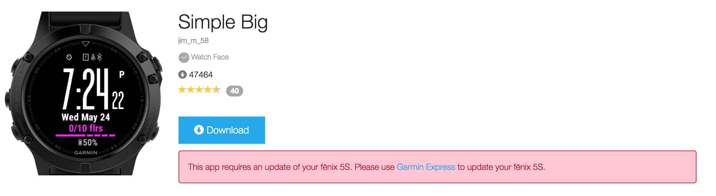

    I'm trying to download Simple Big, but Connect IQ is telling me I have to update my Fenix 5s - but there's nothing to update in Garmin Express. What do I do?community.garmin.com/.../1354566.png
