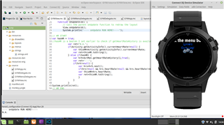

    I tried placing this code in onUpdate, onLayout etc... but nomatter what i do, the simulator crashes with error (to many bla. bla. bla.)

  • What's the crash you see?

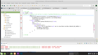

    The error i got is "too long execution", because it keeps counting i guess.
    I tried youre code, but i am getting some errors due to some variables i did not setup i guess?

  • "too long execution" is the watchdog timer tripping, and is typically something like an infinite loop.
    In the code I posted, yes, you'll need to use "var" on some of the things.  In my actual code, they are defined elsewhere. on line 34 add a "var" in front of ret, and then add a line for "var thisHr;" right after that.

    On my 2. picture i did most of that, but you say and then add a line for "var thisHr;
    I simply don't understand what you mean ? :)
    ... Jesper.
  • Ok, in the code, do this starting at line 34 in your code:
    var ret="N.A.";  //add the var
    var thisHR;     //add this line
