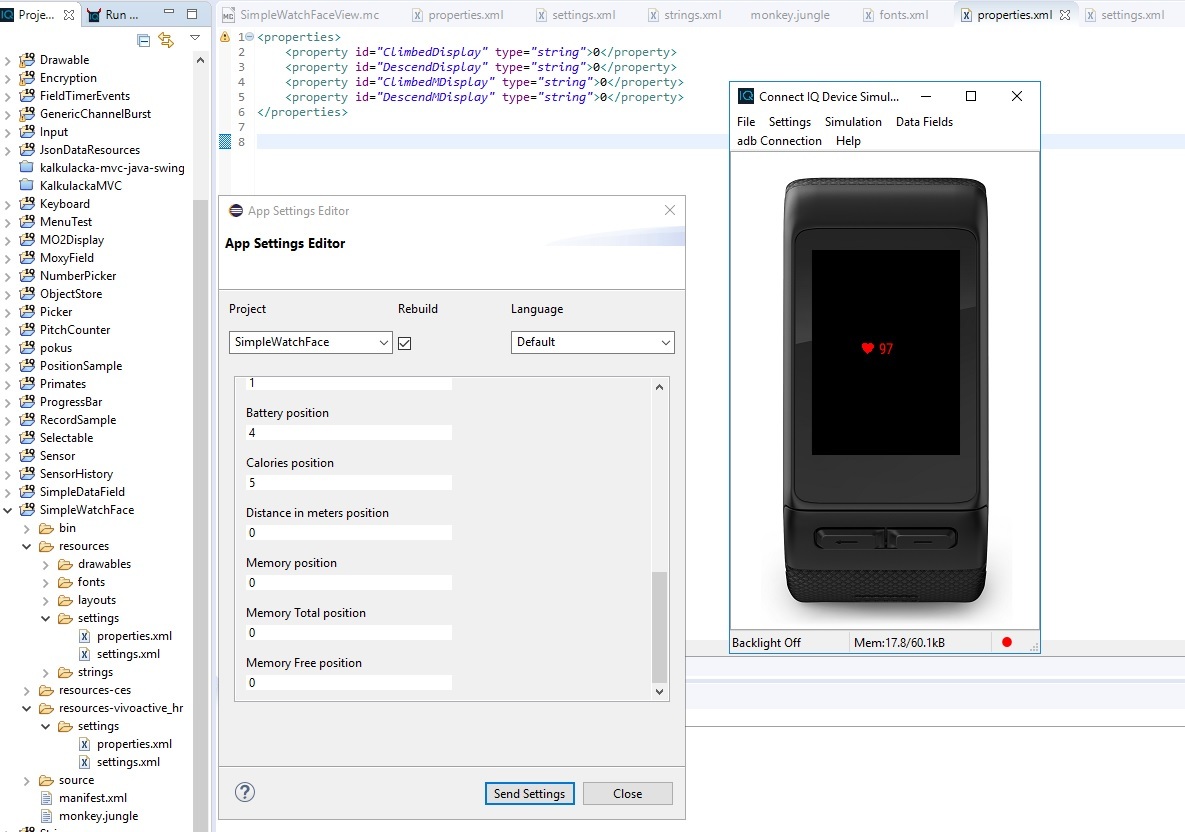

    Thats great thanks for input. It looks like i really want the second option to let default settings for all devices and add some stuff for special.
    so i created resources-vivoactive_hr where in settings.xml and properies.xml i have added floors. But when i built it and see app setting editor in eclipse it shows just default settings. I specified in jungle file
    vivoactive_hr.resourcePath = $(vivoactive_hr.resourcePath);resources-vivoactive_hr
    It looks like i am still doing something wrong.. or i need to test it directly on watches?
    I can't be sure this is the problem, but it sounds like you may not have built the app for the VAHR before opening the app settings.
    The way device-specific builds work is sort of counter-intuitive -- in order to build a given device for the purpose of the app settings editor (and simulator), you have to run the app first. Automatic builds won't work in this case.
    So this is the workflow for testing app settings in the simulator for a given device (e.g. VAHR), after making modifications.
    1) Run app for VAHR
    2) Open app settings (and change them)
    3) Run app for VAHR (again)
  • Actually, with onSettingChanged (prefered), or always reading the settings in something like onUpdate(), you can skip step 3.
    Run the app for the vahr, change settings (you should see the vahr version)...New settings take effect.
    One thing to watch, is if you use a target with floors, then one without, the settings will have the properties you defined for floors. This won't happen on a real device. When you first run the target without floors, in the sim you may want to use file>reset all app data, so that everything goes back to the default for that target.
    And while the settings/properties reflect floors/no floors, if you haven't done so already, use "have" or exclude annotations so the app knows what to do too.
  • I am kinda confuse now. Its still building just default resources. And no additional properties are load at app settings editor...community.garmin.com/.../1461819.jpg
