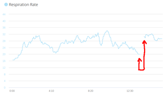

You should read more carefully the original post. This is what he already does (as does my DF), the problem is that it's displayed incorrectly.
FlowState maybe you should open a bugreport about this.
Read the original post, he explains pretty well what he expects (and I as well). Exactly the same as the non-CIQ (build-it) fit values.
i.e. good as the built-in field's missing data is displayed (gap)…
The fit contrib data will be written every second, even if setData isn't called for something lie HR. That's why setData must be called before the data is written. setData does not cause the data to be written
I understand that. Please explain how:
1) If you delay calling setData() *for the first time* (by say 5 minutes), then the first 5 minutes of your graph will have "no data". Obviously since there's no previously written/set value, the firmware chooses to write nothing. (As opposing to writing 0 or a random number)
2) Native fields are able to have "no data" at any point in the graph.
Obviously it's possible for native or CIQ fields to have "no data" (missing FIT records for a given timestamp), it's just not part of the setData() design to be able to do that once you've called setData() for the first time, as I've tried to point out over and over again.
You are describing things as they are, in response to my over-4-year-old request to change that status quo.
My request was for the ability to call setData(null), which would mean "please write 'no data' at the next possible opportunity". I also would have been satisfied with a new function, say "clearData()", which does the same thing.

1), that's likely a FW thing and not a CIQ thing. I don't know. But I do know the reason that devices default to smart recording to reduce the size of the fit files Could be related, as fit contrib causes things to go to 1 sec recording, and no reason to do that until there is data to save
2) Native code works differently than what can be done in CIQ
A) I always have 1-second recording enabled
B) There's other stuff being written to the FIT file other than developer fields, so I'm not sure if this argument holds water. If I delay calling setData() for five minutes, the watch will happily write other fields to the FIT file regardless of that fact.
C) When 1 native field has a gap, it doesn't mean the other native fields also have gaps. (e.g. if I take my watch off my wrist to induce a gap in the HR data, GPS data and cadence data is still recorded.)
It feels like you just don't want to admit that it is totally valid for there to be gaps in FIT data for FIT fields (due to no data being available, not due to smart recording or anything like that), and that this even naturally and intentionally happens for CIQ FIT fields when you delay calling setData() for the first time.
I mean clearly it's a design oversight that this should be possible before you call setData() for the first time but not after.
Obviously Garmin didn't forsee (or care) that any developer would want to write "no data".
But clearly "no data" is not equivalent to 0 or "previous value", either from a mathematical or physical/real-world standpoint.
e.g. Consider an app that connects to a power meter and writes the data to a FIT field:
- 0 means you were standing still
- "no data" would mean that the sensor wasn't connected, and/or there was a drop-out. I mean, ideally it would, except that we can't write "no data" (unless setData() hasn't been called yet.) So we can properly handle the case where the sensor doesn't connect until 5 minutes into the run, but we can't handle the case where sensor disconnects in the middle of the run.
Thanks I realize that. Hence:
It would be nice to have some kind of parity with native fields, especially if the data is to be analyzed automatically later.
I will explicitly state what perhaps I didn't previously make clear: this is a *feature request* asking Garmin to bring parity to CIQ FIT fields and native FIT fields, with regards to gaps in the data.
Also, I feel like you moved the goalposts. First it was "this probably is due to the FIT specification". Then "probably something to do with smart recording". Finally "native code can do stuff CIQ can't". Yeah, I realize that, which is why I made this request.
Also, as I said before, I don't care about this anymore.
Maybe I moved the goal posts, because as I have said, I don't know for sure. Just stating ideas on what may be the cause. And to be honest, it's never bothered me.
As far as the fit spec, I was saying that could have to do with writing a null. As far as smart recording vs 1sec, that has to do with writing anything at all
Not sure why you can't even entertain the idea that the cause might just be that Garmin designed something in a less-than-optimal way. The response to a large number of complaints is "this isn't really a bug" or "I don't use that feature". That sounds a lot like "I don't care" or "Garmin doesn't care", to me. (Which is fine.)
If by your smart recording argument, you're implying that my watch was previously in smart recording mode (allowing gaps to be written in native fields), but the use of a CIQ data field kicked it into 1-second (at which point gaps were no longer allowed in either native fields or CIQ fields), that simply isn't possible, because:
1) I'm always in 1 second mode (although you had no way of knowing that)
2) I already said that data for a CIQ field is allowed to be absent at the beginning of the activity, regardless (simply delay called setData() for the first time, for any length of time you want.) The first data point for the CIQ field will only be written when you call setData() the first time -- it could be 1 hour into a 2 hour activity, for example.
But "recording no data to save space" (when the value hasn't changed) is clearly a different concept than "recording no data when the source data is absent." I haven't looked at the FIT spec in a long time, but I would even guess it would look different in the file itself (otherwise how would Garmin Connect know to "fill in the gaps" in the graph, which it def doesn't do in the case where the source data is absent)
My point was that you said you think the FIT specification doesn't allow for recording no data for given a field, during a certain period of time, when it clearly does, even by your own argument.
To recap - the different known ways that "no data" can be recorded for given field at a given time (even when a watch is set to 1-second mode):
1) When data for a native field is absent (e.g. HR sensor disconnection / dropout)
2) When data for a CIQ field is absent at the beginning of the activity
I don't see why it should be controversial that CIQ can't do what native fields can clearly do, in this regard. The OP was simply a request for parity in that sense. I realize it's not important, and it's never gonna happen, it's just one of those little things that adds up to frustration for me personally, although I don't really care about this problem anymore.
