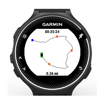

    As far as breadcrumbs, it's really not that difficult, just a large amount of data. You figure out the bounds of the screen, and for what you want to draw, convert the location to an x/y on the screen. Here's the same .fit I was using in the mapview picture but doing my own breadcrumbs. (I stretch the screen to make use of as much as I can, so here, it's a bit screeched right/left)
