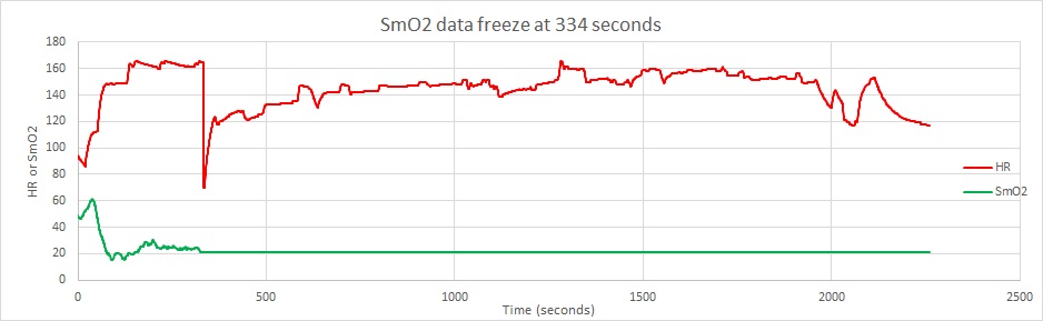

    Here's a FIT file that has data before and after freezing. The freeze is at 00:05:34 This is from a Moxy data field. It's interesting that the HR made a sudden jump in value at the exact same time as the freeze. It was at 165 bpm before the SmO2 freeze and 70 bpm immediately after. There's also something like 6 seconds of data missing at the time of the freeze plus some additional header-like rows written in the FIT file at the time of the freeze. I don't know if any of this is a cause or and effect of the freeze. This was on a VA3. I don't know if they were using optical HR or a HR strap. The user wasn't doing anything at the time of the freeze. You can see that cadence and pace are smooth right through the freeze event.
    http://www.moxymonitor.com/wp-content/uploads/FitData.jpg
    https://connect.garmin.com/modern/activity/2565964608
