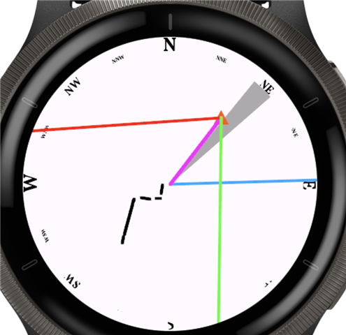

    But the Simulator is smudging the letters - that are 100% clear in the bitmap .png. I don't have a venu2 so can't verify on a physical device.
