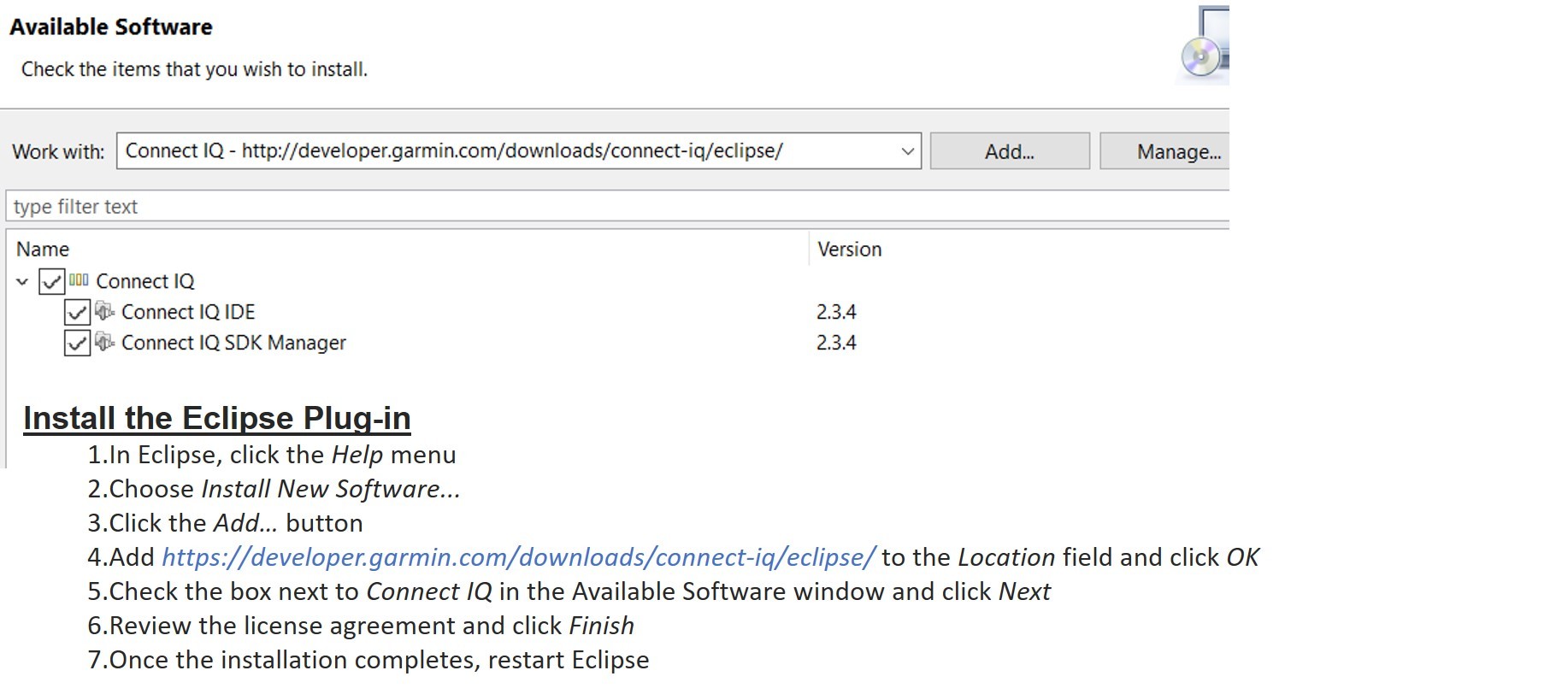

See the attached. Not sure what I'm doing wrong. I installed the brand new SDK 2.3.5 on my computer just fine. Then used the instructions to refresh the eclipse plugin and it seems to only know about the old/existing 2.3.4 version. I'm sure this is something basic I'm overlooking. Ugh. sorry. community.garmin.com/.../1269532.jpg

    That is correct. There is not always a new plugin released with each SDK. The current plugin version is 2.3.4 and the SDK is 2.3.5. There is no 2.3.5 plugin. You should be able to use the new SDK with that plugin without issue.

    There isn't a 2.3.5 plug-in. The version numbers - much to my chagrin - are mirrored between the plug-in and SDK but we don't always have a plug-in update when we have a SDK update. There are several minor SDK updates that only include the addition of a new device/adding regional support to an existing device.

    The simulator is part of the SDK, not the plugin. So you will still have that fix without an updated plugin.
