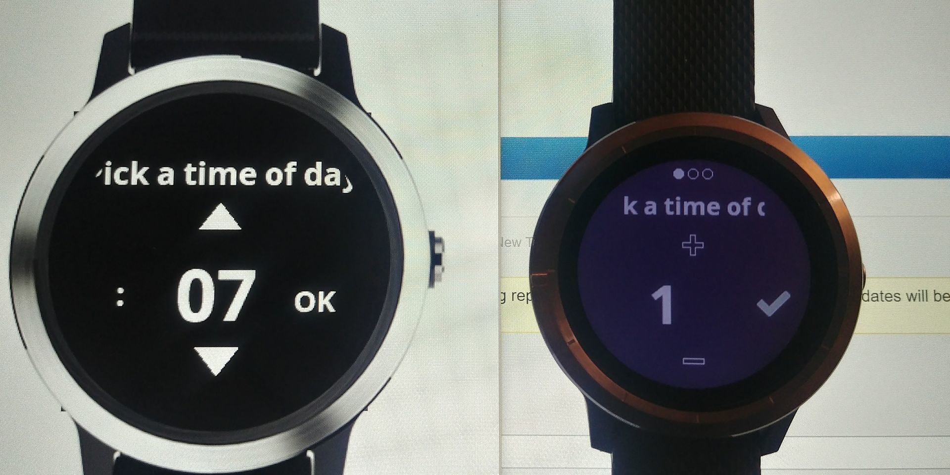

Hello,
I'm trying to port my almost 2 year old app to the Vivoactive 3 (app: https://apps.garmin.com/en-US/apps/e...c-b554bf90865b)
The app has been running fine on a Vivoactive, Vivoactive HR, Fenix 3 & Fenix 5 (and in the sim on all supported devices).
One part of the code uses the generic Picker for a time selection in the HH:MM format, and is based on the sample code provided with the SDK (2.3.4)
Although the app runs fine in the simulator, on the actual VA3 device running V2.60, I have the following problems:
- Time is displayed in HH format (the minutes are missing)
- Need to press multiple times on the "+" symbol to increase a value (the "-" symbol works fine)
- Swiping left to access the confirmation check mark works 1 time out of 5
- The Side swipe does not work at all to increase / decrease values (on the sim neither for this one).
I've side loaded the "Picker" sample provided with the SDK and have the same issues.The attached photo is the comparison of the sample Picker code on the sim and device.
Am I missing something ? Should I switch to the Number Picker (or is it really being deprecated ?)
Thanks for you help
Greg.
community.garmin.com/.../1267397.jpg

  • As you can see in my posted link above, I dont use the number picker. Just the Ui.Picker (which seems not deprecated anywhere), but the ugly not usable result is the same:
    Ui.pushView(new Ui.Picker({:title=>new Ui.Text({:text=>title}),
    :pattern=>[new NumberFactory(99)],
    :defaults=>[value]}),
    new MyPickerDelegate(mode, object, symbol),
    Ui.SLIDE_UP );
    Both, simulator and device got exactly the same setup and both should show 0 Minutes and 45 Seconds.
    As you can see, the simulator does (even when it is cut off a bit) and the real device doesn't.
    If I try to switch to the second number (which is not possible by swiping), I have to hit the green check. Then: Nothing happens, except the dot above indicates, that I'm on the second value.
    Now, hitting + or - it jumps from blank to 46 or 44.
    Again, setting up the Auto. Lap in stock apps, looks great and works fine!community.garmin.com/.../1268400.jpg

  • Hey HerrRiebmann,
    Sorry I've been a little long on getting back to you on this one. It looks like the vivoactive 3 team is looking at it currently and they are prepping it for one of the upcoming maintenance releases. Sorry this one has moved a little slow. That was not the deprecated number picker that was addressed.
    Thanks,
    -Coleman
  • With the release of FW 3.30 for the Vivoactive 3, the generic picker has vastly improved. Thanks!
    Greg
  • ars.fabula,
    That's fantastic news!
    Thanks,
    - Coleman
