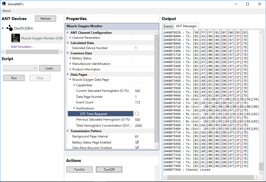

  • I'm not sure I understand the blocking vs non-blocking terminology. However, it looks like my guess above was wrong. If I send multiple acknowledge messages in between transmissions it looks like it buffers the messages and sends them out in response to subsequent received messages.
    I put in the following code. The display device is setup to send it's current time back to the sensor when the sensor requests it. I just added in a bunch more acknowledge messages so I could look in SimulANT+ to see what the messages looked like.

    I got the following response in SimulANT+. It queued up the acknowledge messages in order and sent them one at a time.
    https://cdn2.hubspot.net/hubfs/188620/images/image.png
