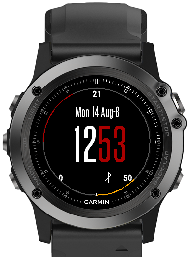

    I have 3 archs
    the red one refers to the seconds(number 21)
    the yellow one to the battery(50%)
    the blank one to the steps/daily goal(0 steps)
    at the simulator everything works like charm
    at the watch the seconds and th arch go with two steps
    like this: 10->12->14 etc rather than 10->11->12->13->14
    and so does the red arch
    and after about 10 seconds both red arch and seconds counter freeze until i press a button
    my guesses are that seconds progress by 2 because of the three arch taking forever to draw
    but even if iremove all three archs therefore have no more lag and so i get steps counting by one
    would they freeze after 10 seconds due to sleep mode?community.garmin.com/.../1240975.png
  • Ok, you understand how watch faces work as far as onUpdate?
    After onEnterSleep is called and before onExitSleep is called, onUpdate gets called once a minute. After onExitSleep is called, you'll have onUpdate called every second for about 10 seconds, then onEnter Sleep is called. This is how it works on a real device. In the sim, you can switch back and forth using settings>Low PowerMode
    So on a real watch, the screen will only change once a minute most of the time. For the 10 seconds after a gesture where it updates every second, things are different.
    even with updates every second, you might see steps jump more than one at a time, unless you only take one step a second.
    When you are in "low power mode" - after onEnterSleep and before onExitSleep, you really can't display seconds unless you use onPartialUpdate, but you probably want to hold off on that until you get the basics working. Also, it may not be available based on the device you are building for.
