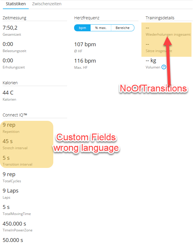

3 custom Fields where shown fine, but in english. (App is set to german, translations are all there)
7 fields refer to existing fields, but where also shown in the custom Connect IQ section

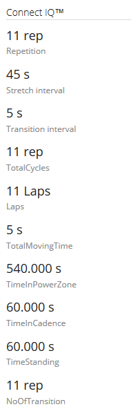

Finally my questions:
- What can I do, to make the custom fields appear in the right language? dataLabel & unitLabel were set dynamically. I also call the field by its translation (...createField(Ui.loadResource(Rez.Strings.menu_label_Rep)...)
- How can I use stock fields, like "NoOfTransition" nativeNum=>113 ?
- Stock field is not affected, it appears under "Connect IQ" section. Number of Transition is zero.
- How to name it properly? Garmin has all translations for none-custom fields. Do I really have to translate them on my own?
- Units in profile.xml says f.e. seconds, factor 1000 for "TimeInCadence" nativeNum=>67 and it is shown in GC in 1:23.45 but my submitted value is displayed in 83450s
