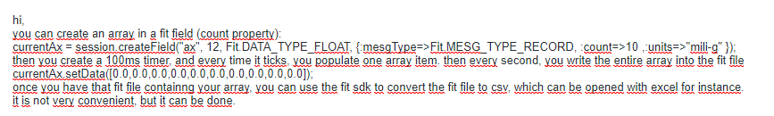

    Hi Brandon,
    is there a way to read the data out and store in the watch? My idea is to create some sort of Accel history i.e every 5 seconds or if I press a button it saves the current Accelerometer coordinates.
    Would you have any ideas?
    Best!
    Andre
  • Have a look at the programmer's guide included with the SDK. There is a section entitled Logging Accelerometer Data that will be of interest to you.
  • Former Member
    Former Member over 8 years ago
    thanks I will have a look!
  • Former Member
    It seems that the logging is only available on CIQ 2.3 which doesnt support Fenix 3 :(
