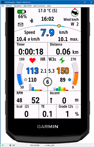

    Sample of text drawing:
    dc.setColor(myWhite, Graphics.COLOR_TRANSPARENT);
    dc.drawText(xof + 25*fx, yof - 7*fx, f_XTINY, notifiCoun.format("%0d"), textCenter);
    Nearly all my text drwaings have background Graphics.COLOR_TRANSPARENT

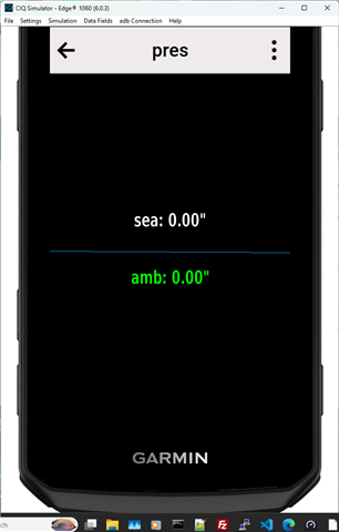

  • Ok, so I started with a very simple widget I use for testing and added the 1060.  drawText for two lines (one with a background color, one with transparent and two different foreground colors.  No problem.  Added a glance view. no problem.  Added a drawLine, no problem.
    Scratching my head now......
