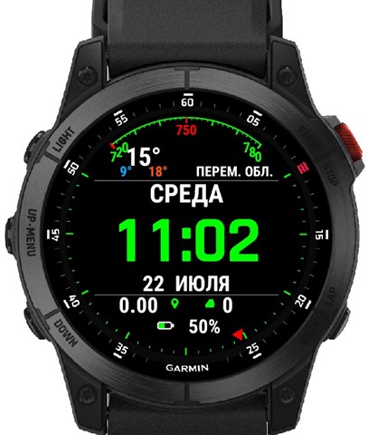

I'm currently developing a Connect IQ Watch Face (targeting AMOLED/MIP devices like Epix Gen 2 and Forerunner series) where the design incorporates a direction/heading arrow pointing along the bezel.

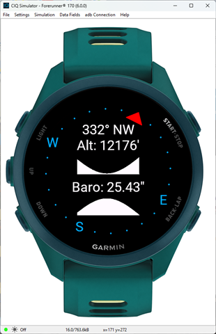

    I did write a widget that displays Altimeter,Barometer and Compass, and there for the compass, I use ared triagle to indicate North and that rotates around the edge with the current heading always at the top.

    Your ABC widget design looks great! Seeing how clean it works in Widget/App mode, I think pivoting to a dedicated Watch App / Widget (assigned to a HotKey) is indeed the right way to go for this use case.
