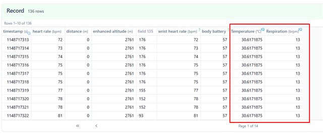

I am trying to display charts on the Garmin Connect App trough FitContributions
these are the two fields I created in the .fit file that I am displaying with fitfileviewer website
everything seems right with this file as it shows the icon GC on the rows
I have created the fields like:

When I create the activity and save it to Garmin Connect I only see these 2 normal charts of heart rate and elevation
I am setting the data correctly with setData, and it is showing the correct data in the .fit file
