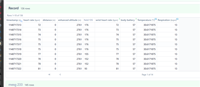

these are the two fields I created in the .fit file that I am displaying with https://www.fitfileviewer.com/

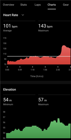

When I create the activity and save it to Garmin Connect I only see these 2 normal charts
I set the data correctly with setData, and it is showing correct in the .fit file
