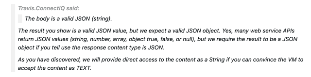

    The result you show is a valid JSON value, but we expect a valid JSON object. Yes, many web service APIs return JSON values (string, number, array, object true, false, or null), but we require the result to be a JSON object if you tell use the response content type is JSON.
    As you have discovered, we will provide direct access to the content as a String if you can convince the VM to accept the content as TEXT.

    I quoted the relevant response from a Connect IQ team member which was posted in 2022 above:
    That response was in the thread that was linked in the OP.
    This has actually caused lots of problems in the past, for people who used JSON endpoints that were returning things other than an object. In the past, the suggestion was to either specify the response type as text and parse the response yourself (if possible), or implement your own proxy which wraps the JSON response in an object.
