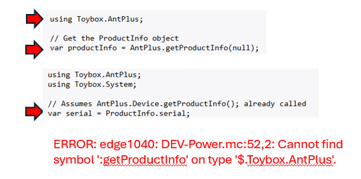

I need a way for any data field running on a device to be able to generate the same "unique" ID for that device. I know there is a "uniqueIdentifier" method, but that is only unique for a particular app. So 2 different data fields running on that same device will generate two different values.
One way would be to get the serial number for an attached power meter. In my use case, for the fields we create there will always be a power meter. So that would work. The ANT ID isn't visible to CIQ, but this suggests the serial number should be. I get this error. Any ideas? Or if this isn't available to data fields, is there another way? I need to support devices from API 2.4 and up.
  • I think you've been led astray by the poor documentation / example.
    Even though the example suggests calling AntPlus.getProductInfo(null), that's really not going to work. getProductInfo() is an instance method which requires an object (an instance of AntPlus). The reason the code/example as written doesn't work is because AntPlus is a class, not an object. Besides, getProductInfo is a member of AntPlus.Device, not AntPlus.
    This is not the only CIQ example in the docs which has a similar problem:
    - the example really needs an object (class instance), not a class
    - the example is confusingly written as though the function could be called on the class
    - mostly importantly, the example does not really explain how to get an instance of the class
