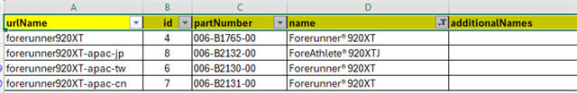

    To expand on this, the ForeAthlete 920XTj and Forerunner 920XT entries in the web store store device list each correspond to  (software) part numbers associated with a given CIQ device (in this case fr920xt). Each CIQ device corresponds to a single hardware part number.
    You can see the complete mapping from store names (like "ForeAthlete 920XTj" and "Forerunner 920XT") to part numbers (and vice-versa) by looking at the API that the web store uses to display that devices tab:
    [https://apps.garmin.com/api/appsLibraryExternalServices/api/asw/deviceTypes]
    This enables you to look at a part number in SOME_DEVICE/compiler.json and see what "user-facing model" this corresponds to, and vice versa, as well as determining the min required firmware/CIQ version for that model (which is sometimes useful for the old devices which have separate part numbers for APAC and WW, and the APAC part number sometimes has a lower firmware/CIQ version than WW).
    It also enables you to construct a URL to filter the webstore by a given part number.
    For example, according to that API, 920XTj is part number 006-B2132-00, and the urlName is "forerunner920XT-apac-jp", which confirms that it's an APAC/Japanese variant, and that one URL to filter the store by that model would be
    [https://apps.garmin.com/en-US/devices/forerunner920XT-apac-jp/apps]
    (You can figure this out by taking a known device URL you can google for like "forerunner 935 connect iq apps" => [https://apps.garmin.com/en-US/devices/forerunner935/apps] and substituting the urlName appropriately.
    Similarly, the main (WW) 920XT's part number is 006-B1765-00, and its urlName is "forerunner920XT".
    You can also that there are 2 other Asian 920XT part numbers, for Taiwan and China. The other two part numbers share the same display name as the main part number ("Forerunner® 920XT"), so in this case "Forerunner® 920XT" in the store probably maps to 3 part numbers.
    Ofc this topic (the relationship between CIQ devices, part numbers, and devices in the store) has been rehashed over and over again for many years, so I'm kind of disappointed there's no official documentation, especially since part numbers are the unit of compilation, not CIQ devices.
  • I converted that JSON to EXCEL which produced 375 lines. I filtered for 920. Interesting

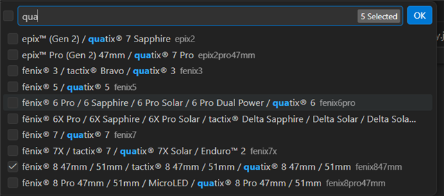

  • There is a device generations with primary names: Quatix 6 and Fenix 6. But not Quatix 3, 5, 7, or 8. So to build for those we need to select the Fenix devices in manifest. Just another inconsistency. This table helps disambiguate those.
