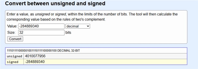

The result of AntPlus Device getProductInfo.serial returns a different serial number for some sensors than the one that actually exists.
For example, my new speed sensor has the serial number shown in the image:
But getProductInfo.serial delivers -284889340 (minus).
It‘s not a big deal but I would like to fix this.
I assume it has to do with the topic of the following thread.
But I don‘t really not know how to get the number in a right way…
Any help appreciated!
