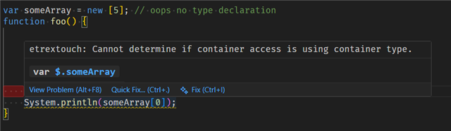

Easy way to recreate the issue:
[both someArray and foo() are at the global scope, so someArray is a global variable]
^ here what the error message is really saying is that someArray is accessed with an integer index, but the compiler doesn't know if it's a container that accepts integer indices (like an Array). (Note that the initial value is an array, but for non-local variables, the compiler wants a type declaration, because it's possible to reassign a non-local variable to a value with adifferent type in a way that the compiler wouldn't know if or when you did so, unlike the case with local variables.

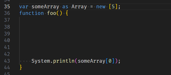

If we tell the compiler that someArray is always an Array, the warning goes away:
