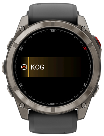

    At first I tried it in the simulator with the Edge 850, but it seems this is not implemented there. However, when using the Fenix 8 Pro in the simulator, the glance is rendered differently. Below is GLANCE_THEME_GOLD:

  • After reviewing your code, I have one suggestion:
    For the background color, I recommend using Graphics.COLOR_TRANSPARENT instead of the system color. Do that if you want the gradient background that some devices have to work properly. You can see this in the Fenix 8 Pro screenshot I posted above.
