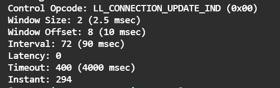

  1. Watch sends CONNECT_IND
  2. Watch sends LL_CONNECTION_UPDATE_IND (see image below)
  3. Peripheral sends LL_TERMINATE_IND with error code Unacceptable Connection Parameters (0x3b) about 35 seconds later
What can I do to work around this?  Do I have any control of the connection parameters in my data field?  Any Garmin BLE experts or ConnectIQ developers that have any insight for controlling BLE connections at this level?
