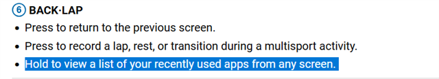

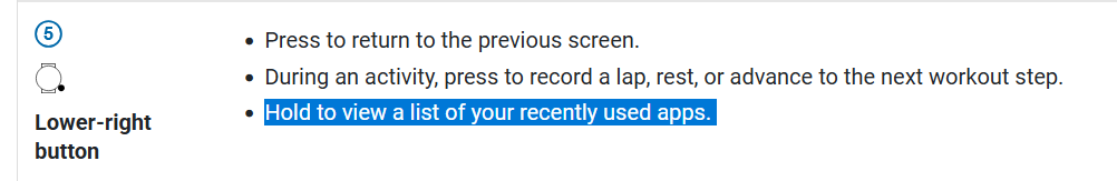

    Just my 2 cents, but I could've sworn that this "multitasking" CIQ stuff is only for devices which have a task switcher (like Fenix 7/7 Pro/8, maybe certain newer Venu/Vivoactive devices, maybe FR570/FR970, but not FR955 and not - as far as I know - FR965 (which is very similar to FR955 except for all the AMOLED things).
    Meaning that I could be wrong, but I don't think your real device ever calls onActive or onInactive.
    I think one way to know if a watch has a "task switcher" is to look in the overview/intro section of the manual. For devices that have a task switcher, the manual will describe some button shortcut or gesture that shows a list of recently used apps (which is the task switcher itself, I guess).
    [1/2]
  • Fenix 7 Manual
    https://www8.garmin.com/manuals/webhelp/GUID-C001C335-A8EC-4A41-AB0E-BAC434259F92/EN-US/GUID-85E597B6-976C-4E1D-AE29-0EBBDDD4613C.html
    Fenix 8 Manual
    www8.garmin.com/.../GUID-9CF7D6B1-E02C-4C67-B45E-F0ABDCC2180A.html
    I noticed that neither the FR955 nor FR965 manuals mention being able to view a list of your recently used apps (and ofc I know from personal experience that FR955 has no such feature).
    Ironically, some Fenix 7 users have complained that CIQ device apps stop recording (and/or exit completely) if you return to the watchface (or something like that), which is not an issue for Fenix 6 / 6 Pro or for Forerunners of a similar generation as Fenix 7.
