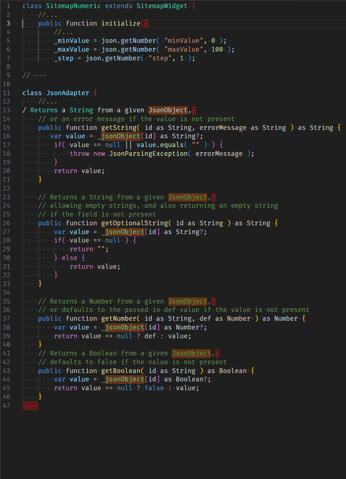

I’ve run into a weird issue and would like your opinions.
I have code that performs some calculations that should produce a Number, and then instantiates an object whose constructor expects a Number.
The compiler seems happy that these calculations result in a Number and allows me to pass the result into the constructor. Later, I store that value in a member typed as Object, and later convert it back to a Number again. At that point I had a safety instanceof check to confirm the Object really is a Number.

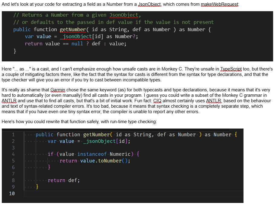

In the simulator everything works fine, but on some real devices (under some conditions) it looks like the calculation results in a Float. Monkey C “duck typing” then lets the Float propagate without complaint until my explicit check, which is how I noticed.
To me the core issue is that the compiler believes the code results in a Number, the simulator behaves accordingly, but real devices sometimes behave differently.

And here is NumericPickable:
class NumericPickable extends CustomPickable {
    public function initialize(value as Number, unit as String) {
        // Workaround: force it to be a Number, so later reads are consistent
        value = value.toNumber();
        // CustomPickable stores the first parameter as Object
        CustomPickable.initialize(value, value.toString() + unit);
Has anyone seen something like this before?
Once I understand what’s going on, the workaround is easy (the extra toNumber() in NumericPickable). But I’d really like to understand why the compiler and simulator treat this as a Number, while some real devices end up producing a Float.
