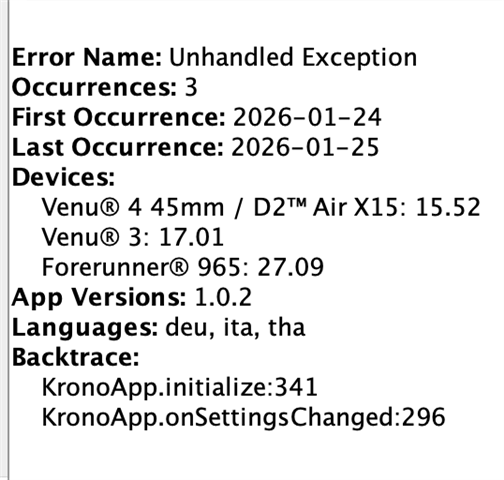

  • I recently posted an app update and here is an example of nonsensical stack trace:
    Line 296 in onSettingsChanged is "WatchUi.requestUpdate();"
    I see these invalid crashes for all post F6 generation watches.
    I'm not as bothered by the crash reports being wrong as I am about the poor user experience people have and that it looks poorly on our CIQ apps!
