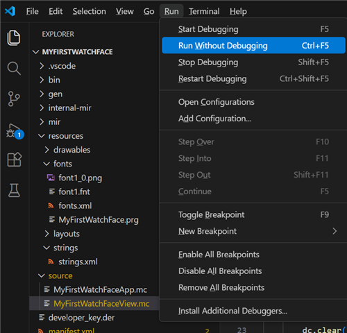

  • Hi, I use Visual Studio Code and SDK8.4, and how I made simulator work was below. hope this helps? this launches simulator and app gets displayed correctly, while when I used Monkey C: Run Tests, I get nothing but gray blank screen on simulator.
