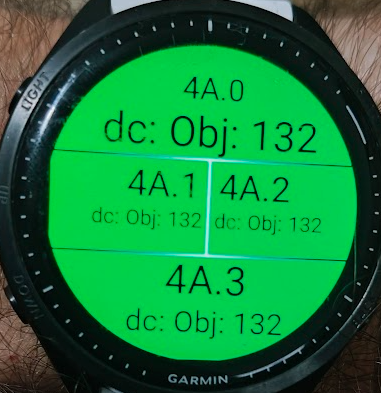

  • While I think it's impossible to differentiate between 2 fields of the same size and obscurity flag, the behavior you describe is not necessarily a feature of the CIQ platform. I think * it is probably just as much determined by the way your DataField is programmed.
    *) I don't have experience with user interaction (aka touch) with datafields.
    BTW I wasted some time in the past trying to crack this thing (with not much success) and you can try out this DF Detector DataField: https://apps.garmin.com/apps/1535a238-cbac-463b-bde2-373403502a6f also on GitHub: https://github.com/flocsy/DFDetector

  • Thanks both -- the DF Detector was really useful in identifying potential problems with watches returning similar or same obscurity flags and sizes, ... and I was OK with the duplication on Edge where two large fields are still rectangular.  My edge-case is where a semi-circular field upper on a watch I would like to process differently to a lower semi-circular layout.
    I could detect two onUpdate() being called with at the same moment and tell one not to update member variables (obscurity) for the onConpute to handle but it was unreliable.  I'll have to give some credit to user common sense (ahahahaahha)
