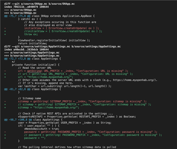

    Is it your openhab app? Is it a version of the code which isn't on github.
    If I run the current code for openhab on edge830 in the sim, I get a different, straightforward error on startup:
    Error: Array Out Of Bounds Error
    Details: Failed invoking <symbol>
    Stack:
      - getCurrentView() at .../openhab-garmin/source/user-interface/view-handling/ViewHandler.mc:32 0x1000a2a3
      - <globals/ErrorView/<statics>/<>get>() at .../openhab-garmin/source/user-interface/error-handling/ErrorView.mc:40 0x10008143
      - createOrUpdate() at .../openhab-garmin/source/user-interface/error-handling/ErrorView.mc:26 0x100080f8
      - getInitialView() at .../openhab-garmin/source/OHApp.mc:78 0x1000a694
    It's straightforward if you look at the code referenced in the stack trace.
    After making a few changes it runs for me.

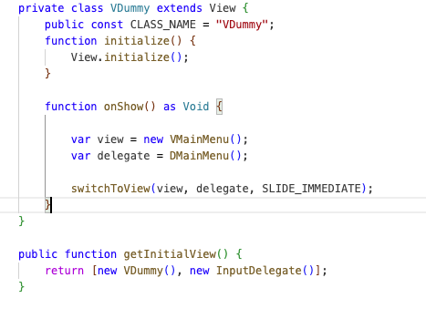

  • I'm not quite sure if I ran into the same issue as you. I use a Menu2 as initial view and tried to launch it on a GPSMap device and it threw the same error you encountered, although it supports Menu2.
    I ended up doing this:

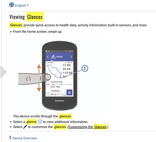

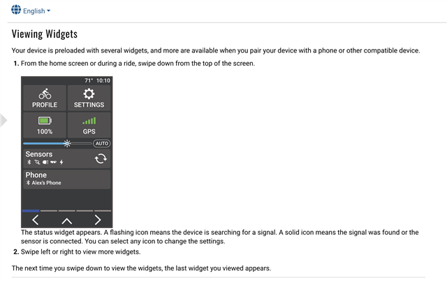

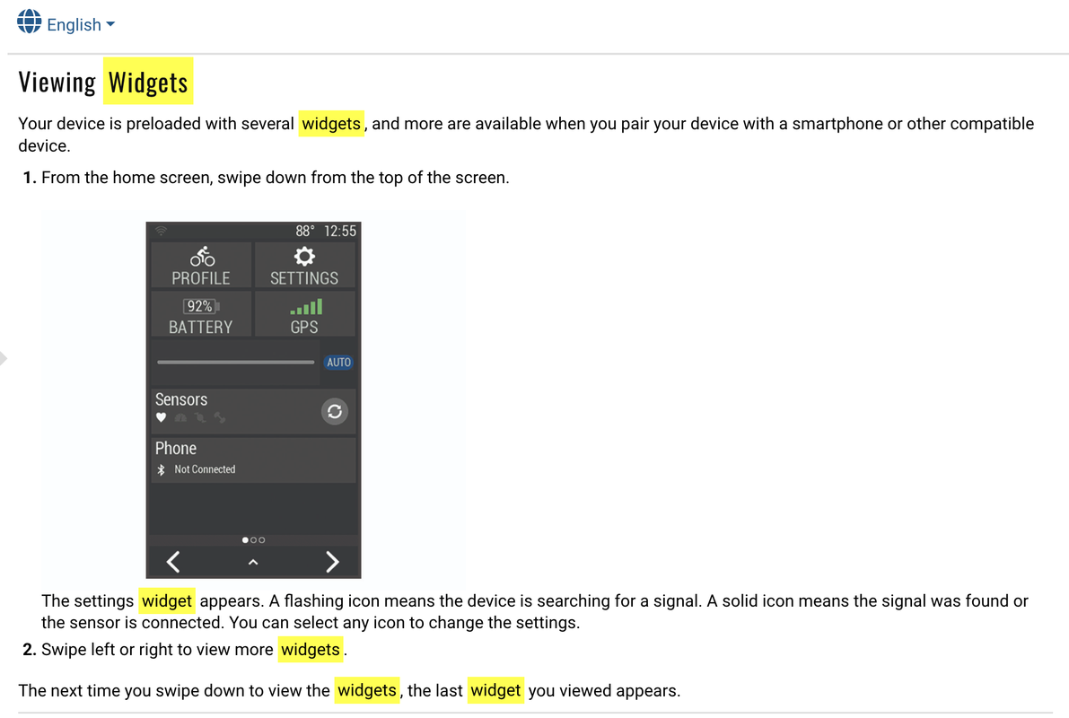

  • Do you by any chance know how this works on the Edge devices? Is there also something like a widget carousel there?
    i don't have first hand experience with this stuff, but I do know that the latest Edges have followed suit from the watches and changed CIQ widgets to glances.
    Unlike watches, these new Edges still have the concept of widgets along with glances. As far as I can tell (based on looking at manuals for newer Edges):
    - widget = settings-related shortcuts that can be easily accessed during an activity (there's a gesture like swiping down from the top of the screen). e.g. user profile, gps, settings, enabled sensors
    - glance = health data, sensor information, activity information and CIQ glances, which are not as easily accessible during an activity (I think multiple gestures are required - go to home screen and swipe up.) Tbf, the manual also says that widgets are accessed by going to the *home screen* and swiping down, but I *think* widgets may also be accessible by swiping down during an activity? At least that's what I gathered from dev complaints about glances being less accessible than widgets, meaning they wish CIQ widgets remained widgets and didn't move to the glances section in new Edges.
    Regardless of what the UX is like for Edge widgets, I think the rules for the top level view are the same as that of watch widgets.

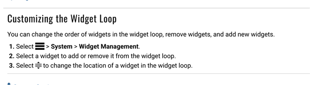

    Looking at the manuals:
    -  I think edge 1030 only supports widgets, and it talks about a "widget loop" (same concept that the old watches had):
    www8.garmin.com/.../GUID-8932D61A-C839-4704-BB71-3C2383B43A54.html
    https://www8.garmin.com/manuals/webhelp/edge1030/EN-US/GUID-E741F23E-5A41-4490-8D17-8CB05FA626CA.html
    - I think Edge 1040 supports both widgets and glances. The widget section of the manual is more or less identical to that of the edge 1030

    TL;DR
    - older edges only support widgets and not glances. Widgets seem to be settings/profile-related stuff as well as ciq widgets
    - newer edges support both widgets and glances. Widgets seem to be settings/profile-related stuff. Glances seem to be health, activity, and sensor data, as well as CIQ glances
    - for both older and newer edges, native widgets seem to be more about toggles / quick access to settings (and user profile) as opposed to data?
    - for newer edges, native glances seem to be more about data. However, since older edges don't have glances, I don't know if the data that glances provide on newer edges was provided as widgets on older edges, or if it just wasn't available at a glance. I don't know anything about edges tbh.
    - I think the rules for widgets/glances are the same for both watches and edges, even if those rules don't necessarily make sense on an edge
    - on an edge, it may or may not be more inconvenient to access glances as opposed to widgets
