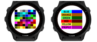

I asked a bunch of users to run my color palette test field and post photos. People with a wide variety of watches responded. I had to tweak the RED pair for the Fenix 5x. I needed a decent light/dark contrast for a number of colors. The lap button toggles between the 64 color grid and a 6-color light/dark. The AMOLED and LCD displays are of course amazing, but the MIP ones were more challenging. In case this is helpful to anyone, here are the HEX codes I ended up with.
This screen show is just the simulator for a FR955, but you can't trust the sim colors. It does look good on my actual FR955.
apps.garmin.com/.../ff11a00c-b563-45d5-9cff-c9feff6b5f5e
